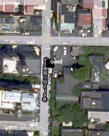

可以參考Overlay方法
需要自己建立一個Overlay物件
[quote]
class MyOverlay extends Overlay{
@Override
public boolean draw(Canvas canvas,MapView mv,boolean shadow, long when){
Projection pro = mv.getProjection();
Point point = new Point();
pro.toPixels(p, point);
Paint blackPaint = new Paint();
RectF rect = new RectF(point.x-10,point.y-10,point.x+10,point.y+10);
blackPaint.setColor(Color.BLACK);
canvas.drawRect(rect , blackPaint);
Paint whitePaint = new Paint();
whitePaint.setColor(Color.WHITE);
whitePaint.setFakeBoldText(true);
whitePaint.setAntiAlias(true);
canvas.drawText("Good", point.x, point.y, whitePaint);
return super.draw(canvas, mv, shadow, when);
[/quote]
然後將他給加入到MapView的Overlay就可以了
List<Overlay> mapOverlays = mv.getOverlays();
Overlay overlay = new MyOverlay();
mapOverlays.add(overlay);
這只是我測試的範例,詳細應用要自行修改 :)

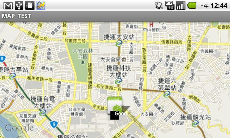

參考看看
List mapOverlays = mv.getOverlays();
//Overlay overlay = new MyOverlay();
MyOverlay overlay = new MyOverlay(this.getResources().getDrawable(R.drawable.icon));
p = new GeoPoint((int)(25.02639*1E6),(int)(121.542757*1E6));
OverlayItem overlayitem = new OverlayItem(p, "Title", "Snippet");
overlay.addOverley(overlayitem);
p = new GeoPoint((int)(25.02000*1E6),(int)(121.542757*1E6));
OverlayItem overlayitem2 = new OverlayItem(p, "Title", "Snippet");
overlay.addOverley(overlayitem2);
class MyOverlay extends ItemizedOverlay{
private ArrayList mOverlays = new ArrayList();
public MyOverlay(Drawable defaultMarker) {
super(boundCenterBottom(defaultMarker));
//super(defaultMarker);
// TODO Auto-generated constructor stub
@Override
public boolean onTap(int index){
// Toast index...
return false;
@Override
protected OverlayItem createItem(int i) {
// TODO Auto-generated method stub
//boundCenterBottom(main.this.getResources().getDrawable(R.drawable.icon));
return mOverlays.get(i);
@Override
public int size() {
return mOverlays.size();
public void addOverley(OverlayItem overley){
mOverlays.add(overley);
populate();
List
private ArrayList
@Override
// Toast index...
return false;
@Override
@Override
public int size() {
populate();
就改成你要得Icon
然後開啟Dialog或是其他方式
應該可以達到你要得效果
就改成你要得Icon
然後開啟Dialog或是其他方式
應該可以達到你要得效果

我有一個Overlay的JAVA負責座標上畫文字Drawable
這件事
另一個Map的JAVA是主程式,並且也用了下面方法在onCreate時呼叫了Overlay的JAVA來畫上我要的文字Drawable
List<Overlay> mapOverlays=map.getOverlays();

可以用
利用資料結構的方法重新繪圖
[quote]
for(int ax=0;ax<10;ax++){
[/quote]
